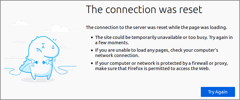

13.5.3.2. Server ThreadPool Settings
A high reliability server process like SavaPage must reject excess requests immediately (fail fast) by using a Request Queue with a bounded capacity.
When a request is rejected, the user browser will show a diagnostic message, for example that “The connection to the server was reset while the page was loading” because “The site could be temporarily unavailable or too busy”, with the advise to “Try again in a few moments”.
Rejected request in Firefox browser
Figure 13.1. Rejected request in Firefox browser
Request Queue capacity is calculated according to a tolerable “no-response” time.
For example, if the server is capable of handling 100 requests per second, and 30 seconds of patience is accepted by users in the event of excessive high load, you can set the queue capacity to 30*100=3000.
If queue capacity is set too low, the server will reject requests too soon and won't be able to handle normal load spikes. If set too high, a high load, that exceeds the processing power of the server application, will continue to stack requests on the queue. And thus, even after the load stops, the application will appear to have stopped responding to new requests as it still has lots of requests on the queue to handle.
Requests are FIFO processed by threads contained in a ThreadPool. The maximum number of threads needed, in order to achieve the best performance, depends on host resources (RAM and CPU cores) assigned to the SavaPage application. The maximum value will typically be between 50 and 500.
The keys to set thread pool and queue capacity in the server.properties file are shown in the table below.
KeyDescription
server.threadpool.queue.capacity
The capacity (maximum length) of the queue holding client requests to the server. Requests are FIFO processed by threads in the pool. Default: 3000
server.threadpool.maxthreads
Maximum number of threads in the pool. Default: 200
server.threadpool.minthreads
Minimum number of threads in the pool. Default: 20
server.threadpool.idle-timeout-msec
Maximum time a thread may be idle in milliseconds after it is terminated. Default: 30000
Table 13.6. ThreadPool Settings: server.properties
ThreadPool settings are part of application performance tuning. See Chapter 22, Tuning in general and Section 22.1, “Linux Kernel Parameters” in particular.
The browser “connection reset” message can be easily provoked by setting very low threadpool values, like:
server.threadpool.queue.capacity=4
server.threadpool.minthreads=1
server.threadpool.maxthreads=5
server.threadpool.idle-timeout-msec=10000
... and frantically pressing the F5 browser key.
