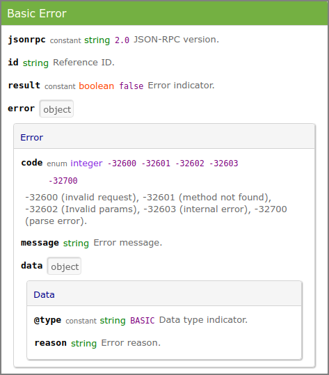

The sections below discuss the individual methods. All methods default to the same response layout in case of an error.
JSON-RPC : Basic Error
Figure C.1. JSON-RPC : Basic Error

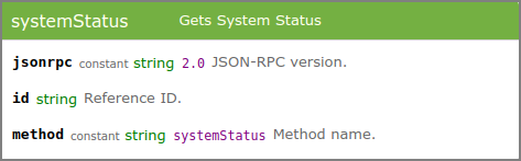

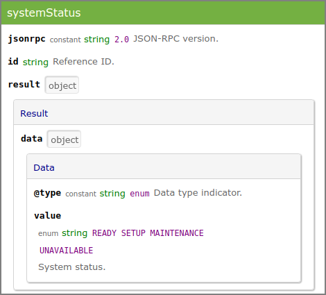

C.2.2.1. systemStatus
This method returns the system status as enum value. READY indicates the system is ready to use and users have access to the Web App. All other values indicate that user access is denied, because: system SETUP is needed, MAINTENANCE is in progress, or the system is temporarily UNAVAILABLE due to running batch jobs (database backup, user synchronization, database cleanup).
Although the system can have multiple "deny status" at the same time, the single most important status is returned, in the order SETUP, MAINTENANCE, UNAVAILABLE.
JSON-RPC : systemStatus (request)
Figure C.2. JSON-RPC : systemStatus (request)
JSON-RPC : systemStatus (response)
Figure C.3. JSON-RPC : systemStatus (response)
# sample request
curl -k --request POST --header "X-Auth-Key: 7961b5ec-bee4-11e7-8731-406186940c49" \
     --data '{"jsonrpc":"2.0","id":"reference","method":"systemStatus"}' \
     https://savapage:8632/jsonrpc/v1
# sample response
  "jsonrpc" : "2.0",
  "id" : "reference",
  "result" : {
    "data" : {
      "@type" : "enum",
      "value" : "READY"

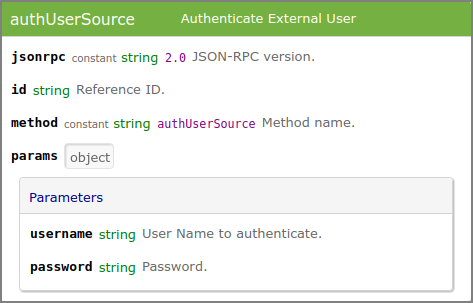

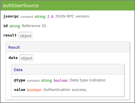

C.2.2.2. authUserSource
This method authenticates an external user against the configured User Source.
JSON-RPC : authUserSource (request)
Figure C.4. JSON-RPC : authUserSource (request)
JSON-RPC : authUserSource (response)
Figure C.5. JSON-RPC : authUserSource (response)
# sample request
     --data '{"jsonrpc":"2.0","id":"reference","method":"authUserSource", \
               "params":{"username":"john","password":"AzFi7I"}}'
# sample response
  "jsonrpc" : "2.0",
  "id" : "reference",
  "result" : {
    "data" : {
      "@type" : "boolean",
      "value" : true
